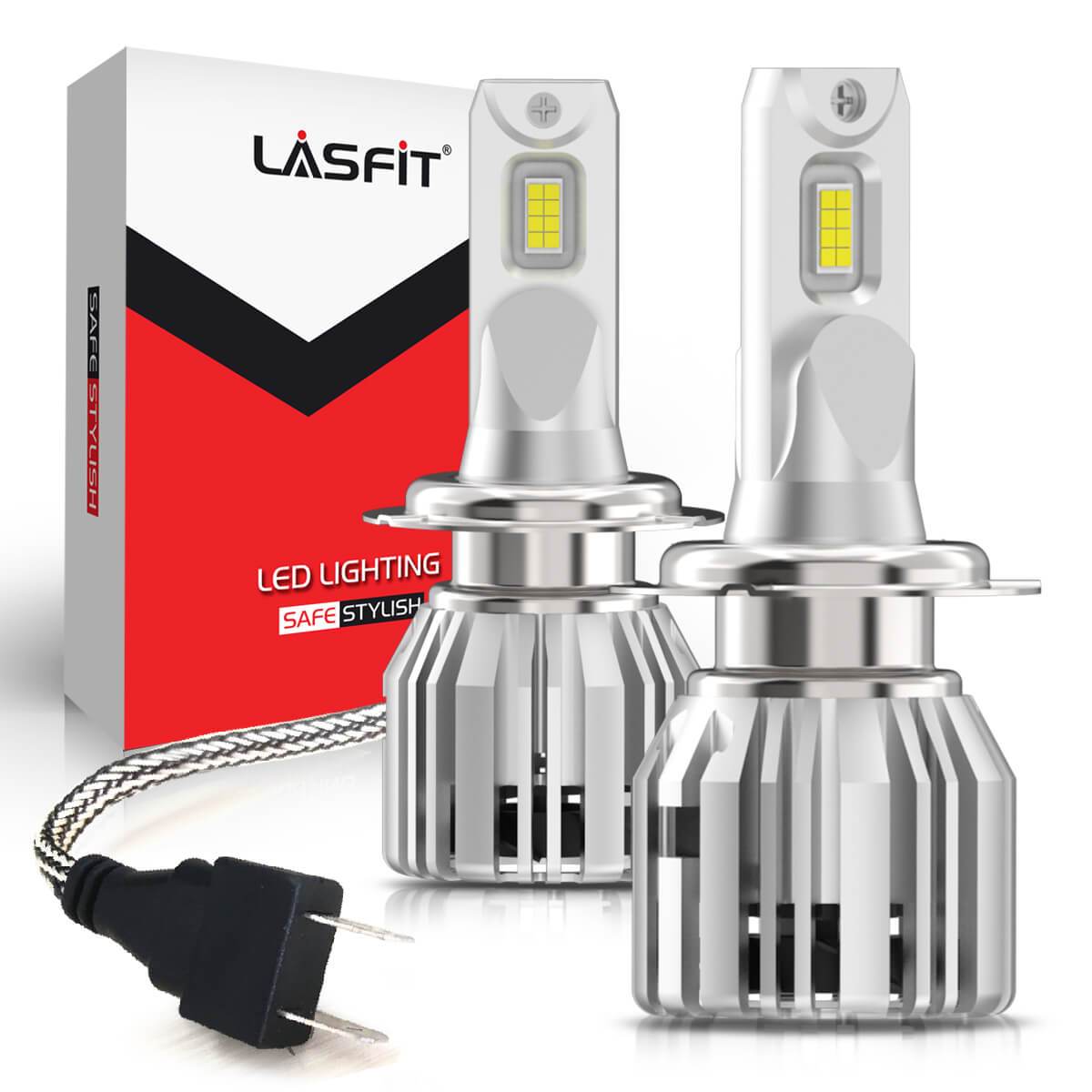

There is a similar thread in the GT Modification section, and I posted a lot of information on page 6. A member posted his succes in using the Lasfit brand: F800GT full LED headlights system
With the stock filament bulb I often had people in cars/truck pulling out in front of me - with the brighter/whiter LED it happens far less often.....I believe the light is far more noticeable in the daylight.
There are hundreds of poorly made LED bulbs - I have bought a few crappy ones and the beam pattern can be awful with dark and light blotches, and inadequate control of the upper cutoff on low beam. It is not unusual for the LED to be polarity specific, and if the LED doesn't work initially you may need to reverse the polarity of the connector. I also believe the CanBus is looking for a certain amount of current draw from the bulb, and if it doesn't see that minimum amount the error code can be triggered (as I mention below a Lasfit 35 watt bulb triggered the Canbus in my R1200RT but the same brand 50 watt did not and I am running that bulb in my R1200).
I have had very good luck with a couple of light brands.....Lasfit and Cyclops.
With the Lasfit brand you get a good light pattern, a self contained light without a separate driver, and an affordable price. They only come in pairs....so you get bulbs for both high and low beams in the same order! The 35 watt model tripped the Canbus in the R1200RT - but worked in the F800GT. The 50 watt model worked in both without triggering the CanBus. You may be able to get these to work without the extended caps in the headlight housing....but I used the longer caps.
