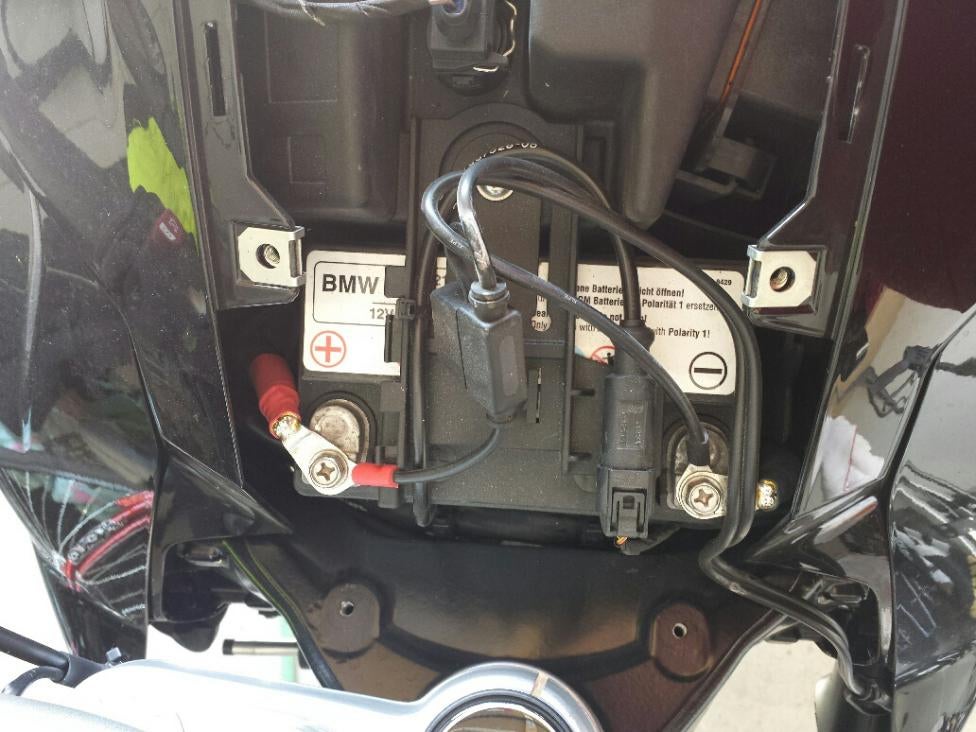

Thanks for the info. I decided to go the simple route and just install a standard 12v power socket. This leaves me some flexibility in swapping out GPS's, I also have the BMW plug rigged with a lead that has a standard 12v socket on it for charging things like my phone in my tankbag. The install for an extra plug is pretty simple with the part from the above mentioned posts, just plug it in and connect to what ever you fancy, I've tried mine a few times and it's been shutting down fine after about a minute. The tricky part is cutting the hole in the ignition plate, I used a dremmel tool and it turned out pretty neat, just have to be accurate to ensure the socket has proper clearance below.

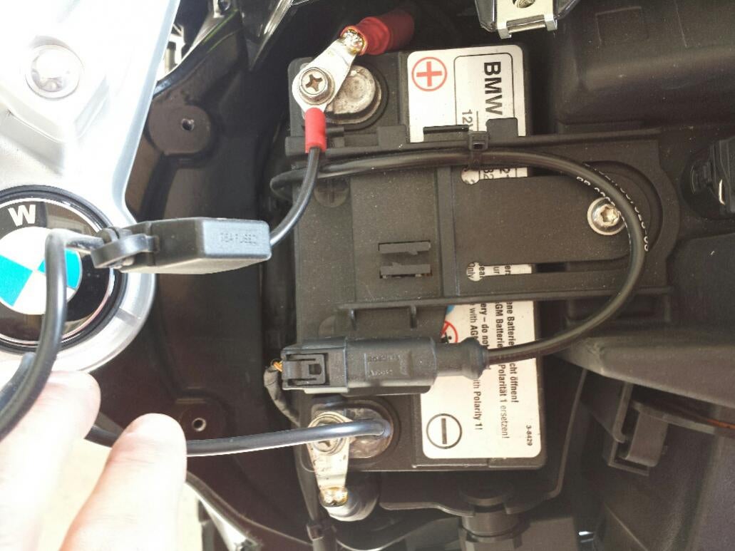

Just installed as per the instructions above - simples!! Getting to the socket is straightforward- just attached with a piece of tape on the pos battery cable tucked to the side of the battery.

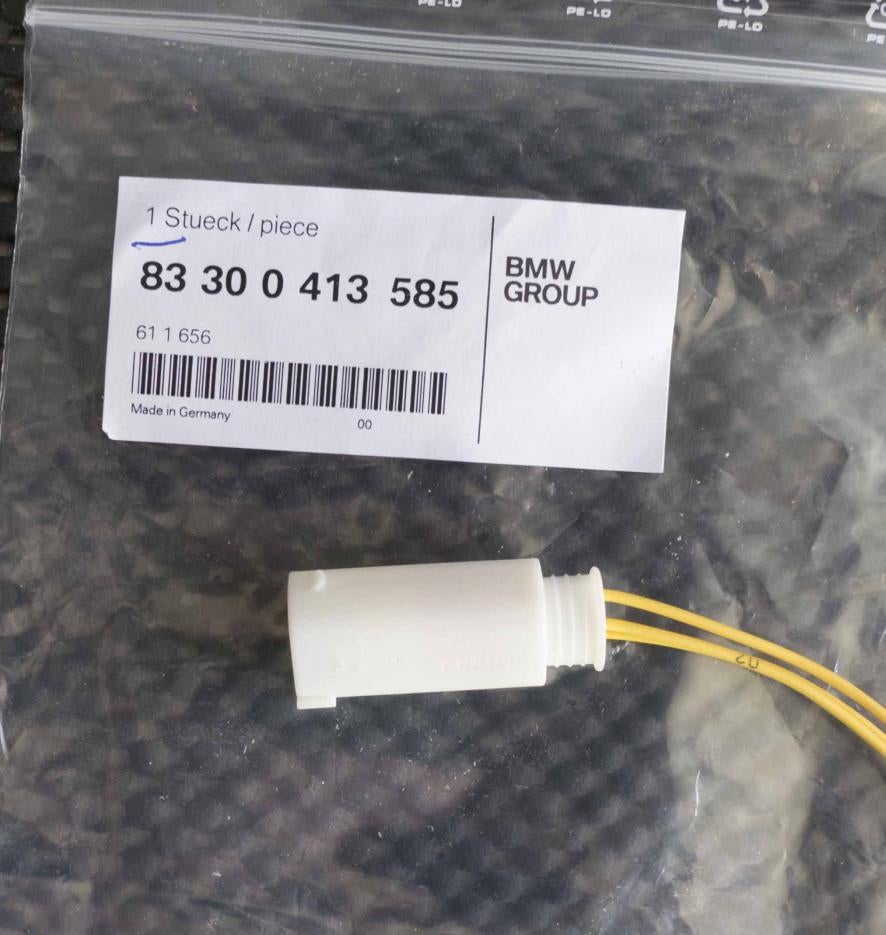

Bought in Canada today. P/N was 83300413585. $24.99 CDN $.
Bought one in South London UK this afternoon for ÂŁ11.27 inc VAT. The packaging is identical to the one bought in Canada and pictured above. The dealer was very helpful in confirmng that I should be able to make up the lead and they will connect it when my bike has its service in a couple of days.
