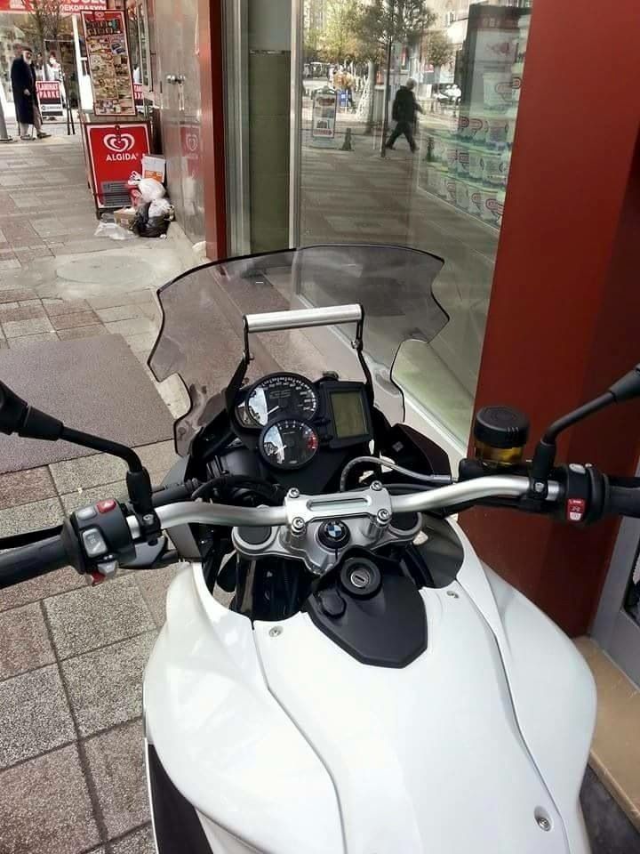

Didn't get around do doing properly on my 700 but for my F800GS I wanted to get the GPS just where I like it. When you have a standard GS not GSA or don't have an aftermarket screen with support plates/brackets getting your GPS above the cluster is a challenge.
I really like this one, mounts it very solid.
Plate attached to lower fairing mount on steel frame, very solid
Plate sits on cluster mounting platform, I added a bit of rubber and cable tie to add to solid set up

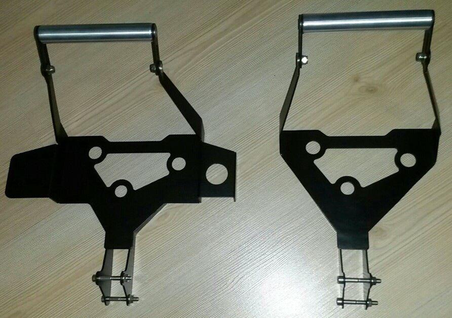

There's 2 types of holders, one with side wings to mount other electronics, and one without. Different dia crossbars are available, mine is 12mm as that is what the couple of GPS adapters I already had where, and it comes with an extension hinged section for taller screens which I didn't use.
It's Touratech quality that's for sure, in fact I can't believe they haven't made it
