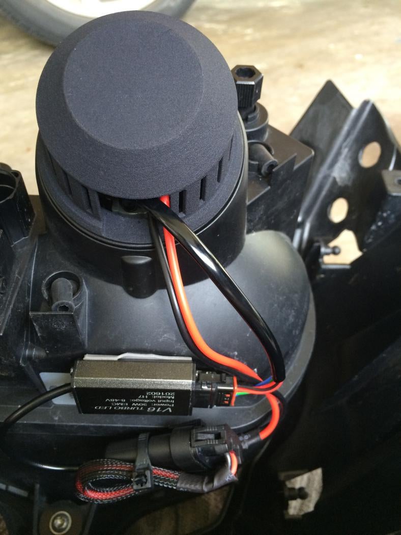

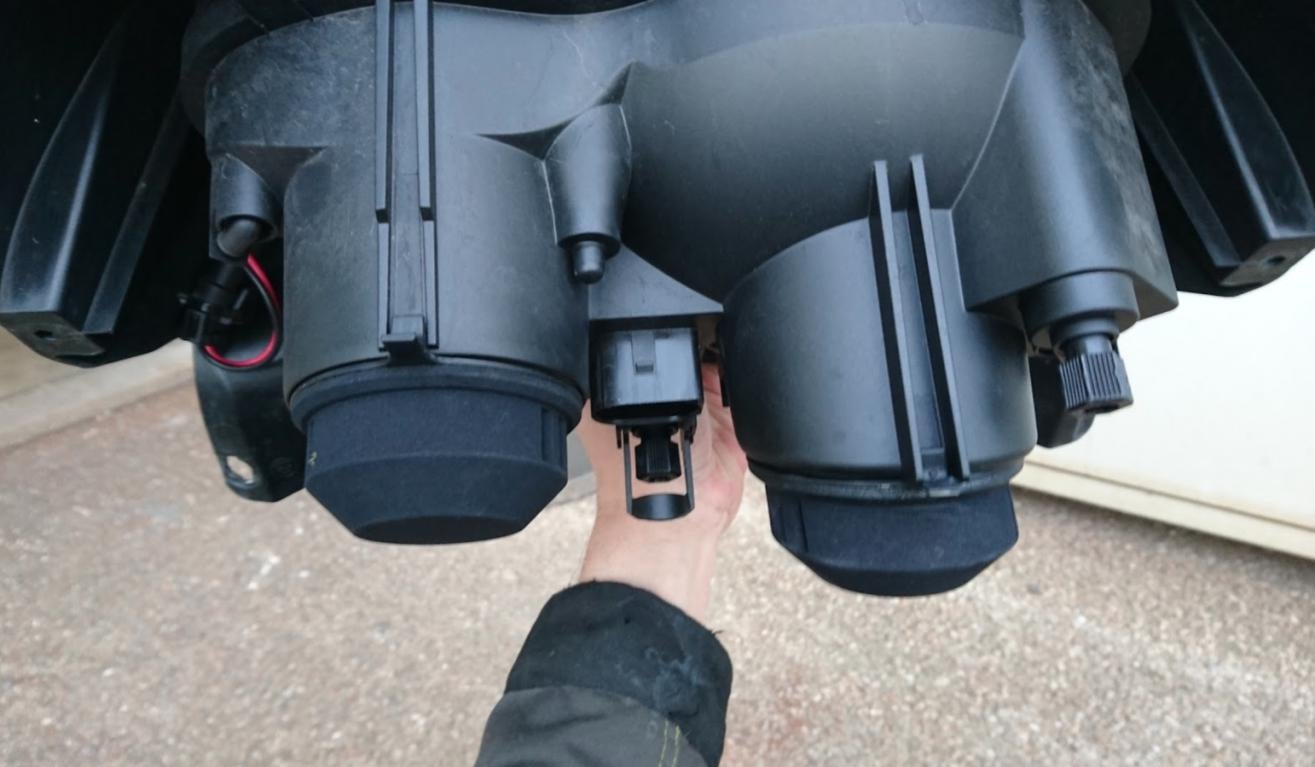

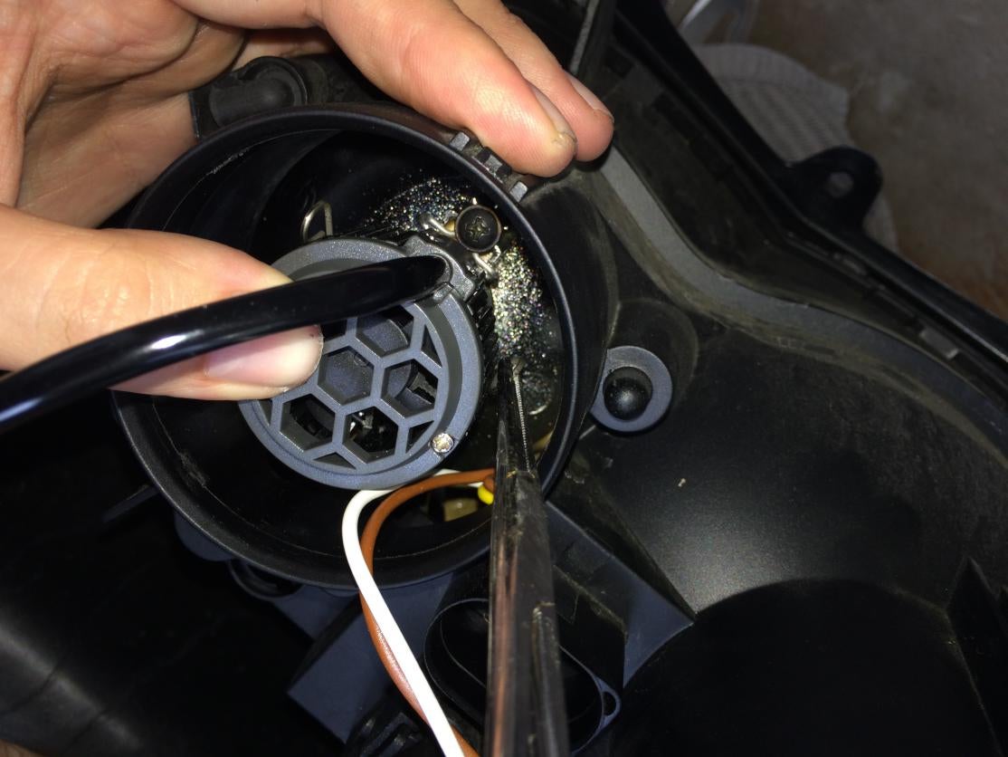

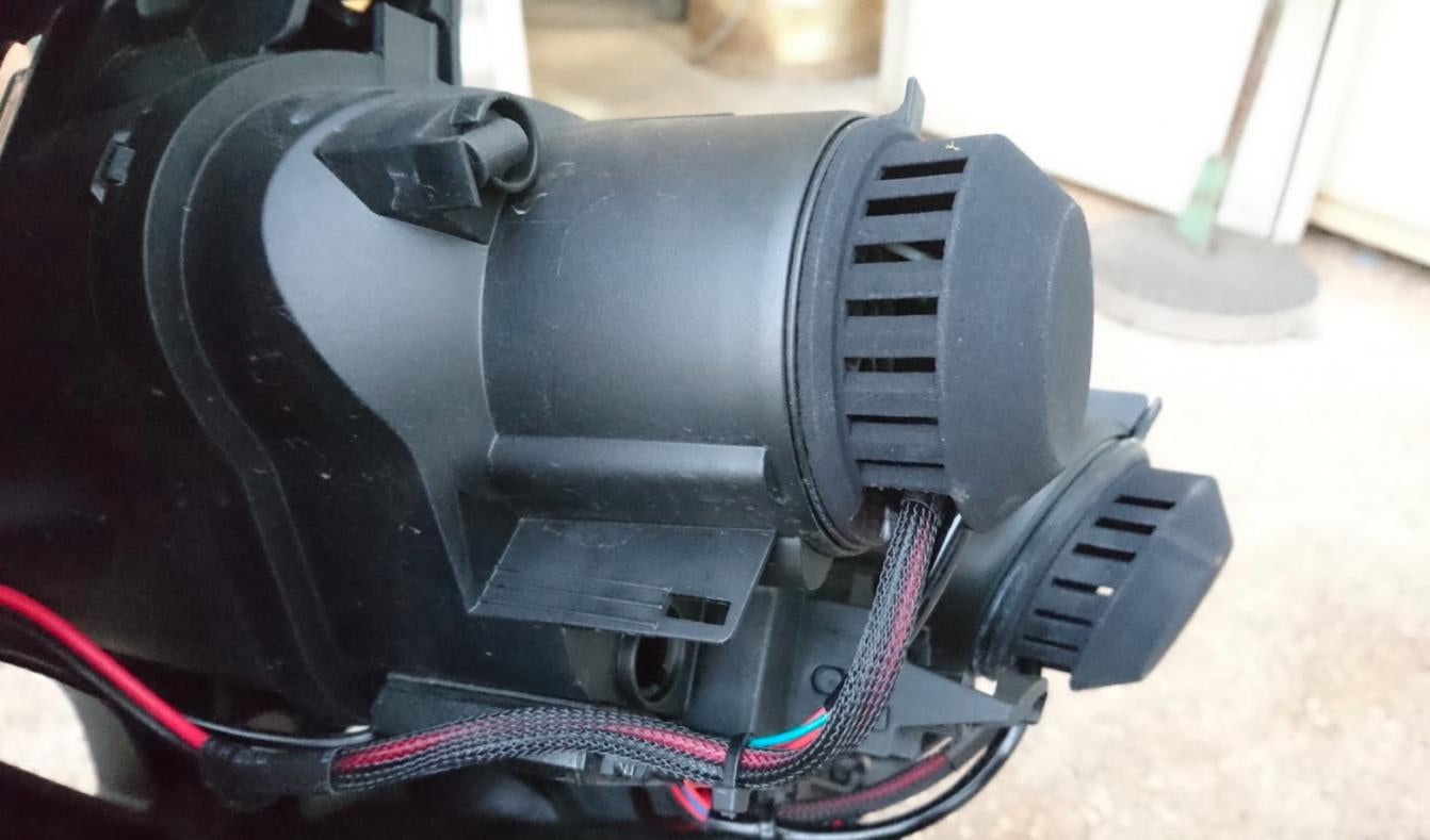

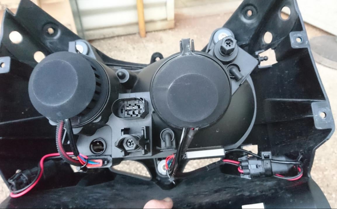

Upon reception, I mounted them in the headlight block, but I struggled a bit to clamp the spring wire retainer, as the LED bulb base is bulky. It carries the fan and the heat sink to there is a recess between the flange and the housing to clear the spring retainer, but not much. I used a small plier and after 5mn of struggle I finally locked them in place.

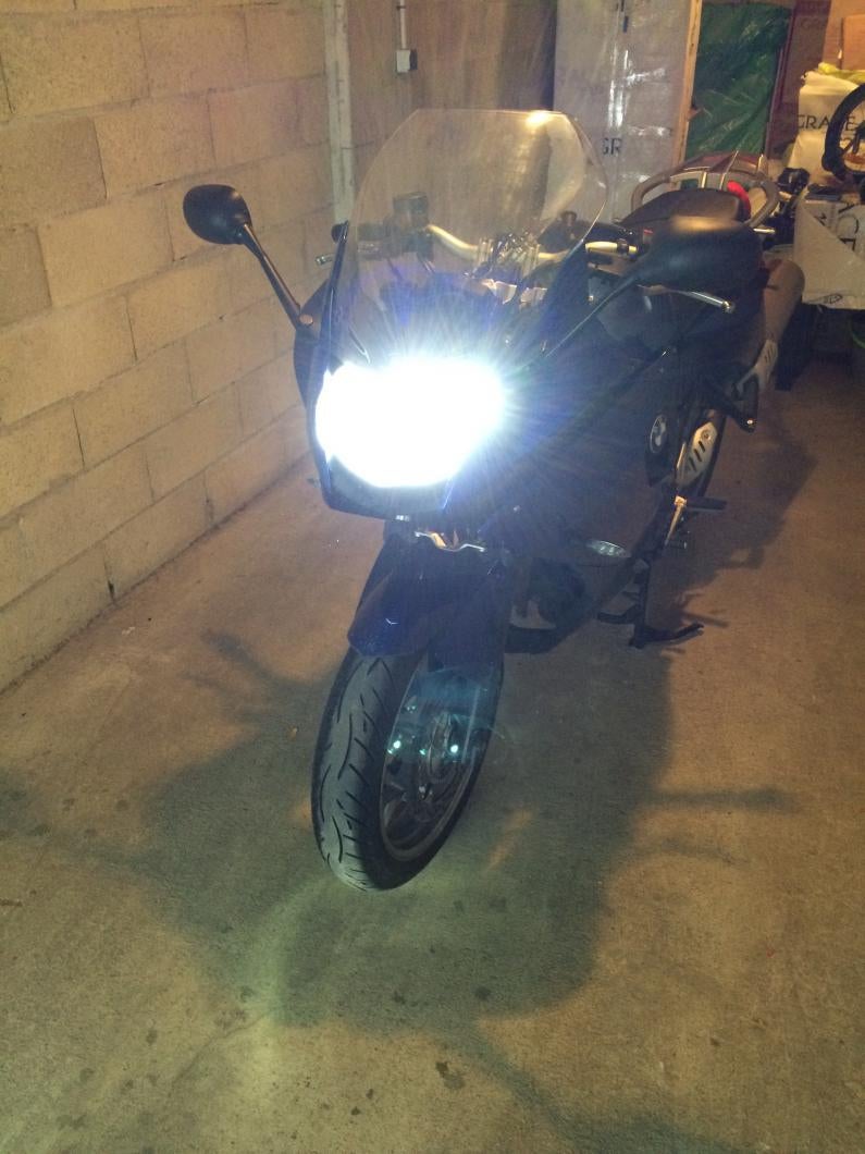

I connected them without the CAN bus error filter and I worked perfectly with a HUGE amount of light available. This is a chalk and cheese difference. There is no way I'm switching back to a halogen bulb, ever, period.

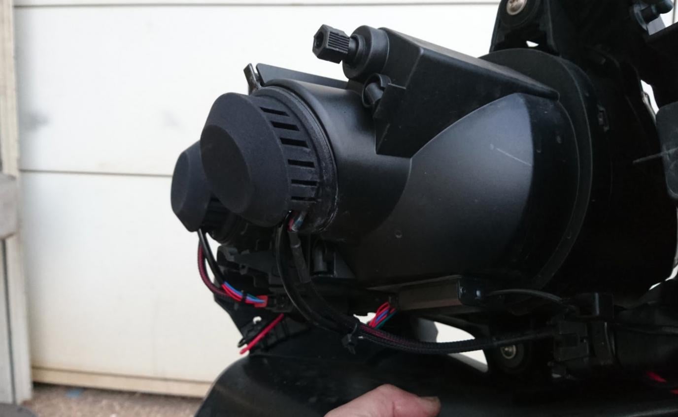

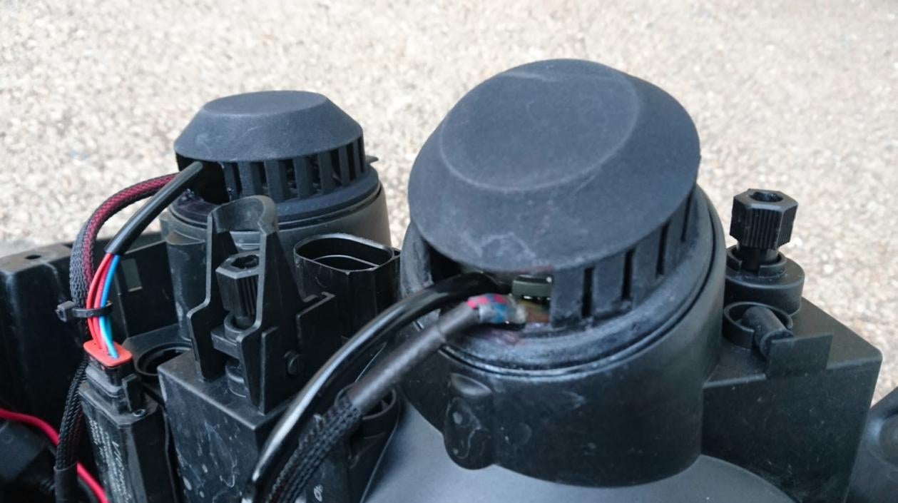

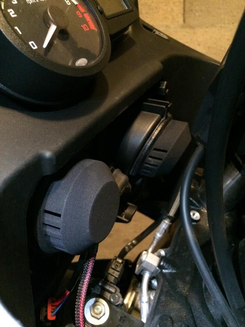

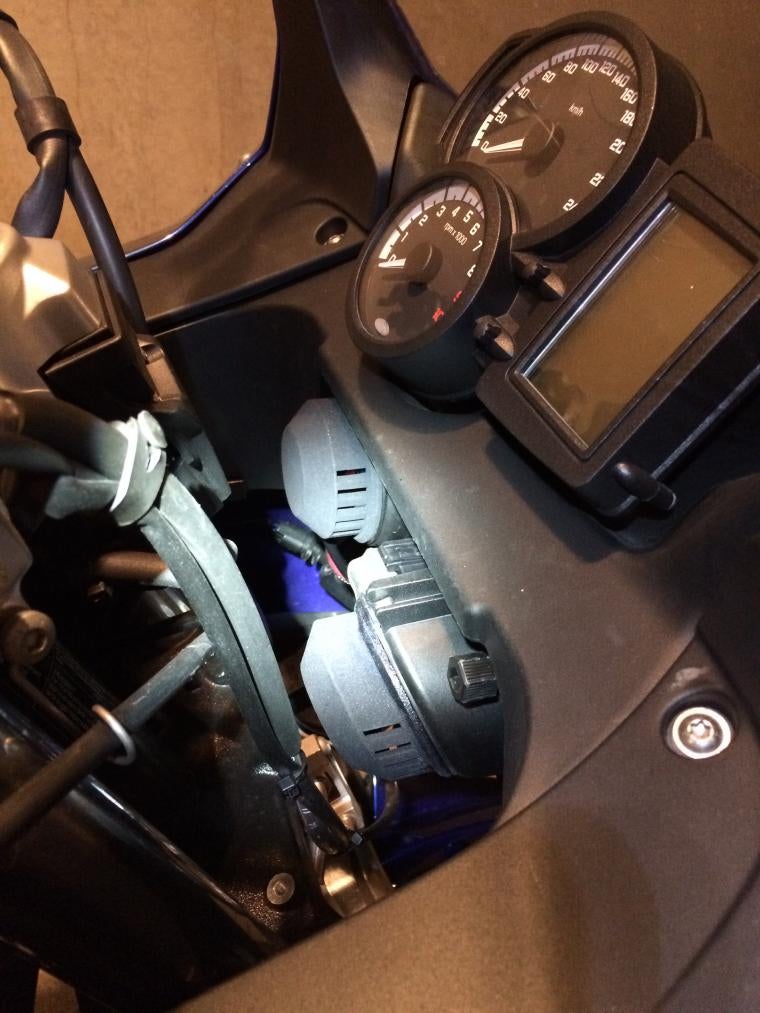

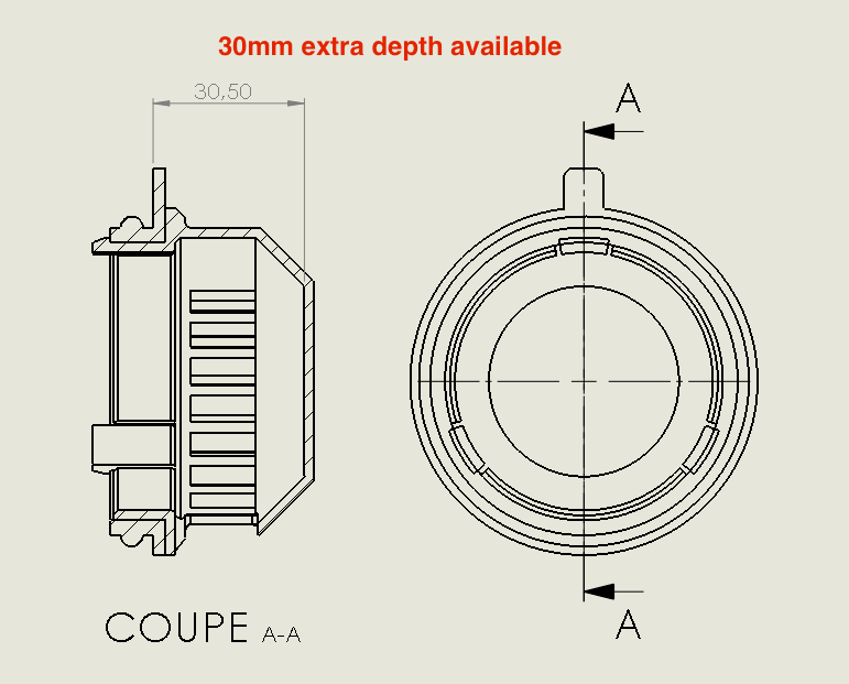

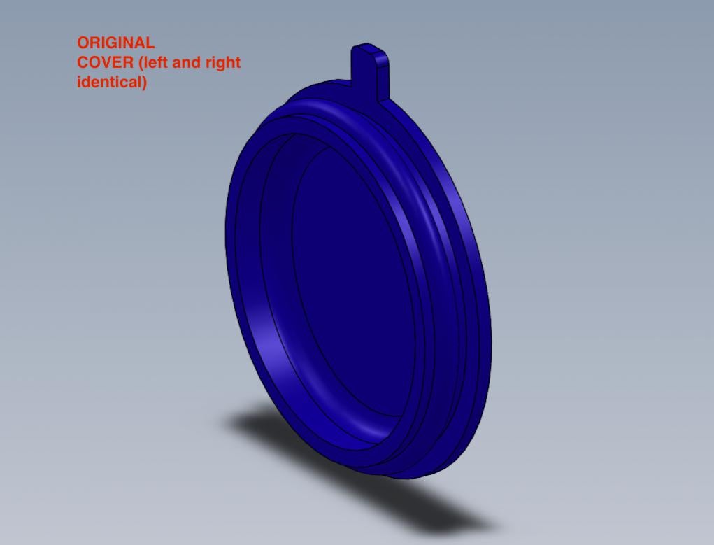

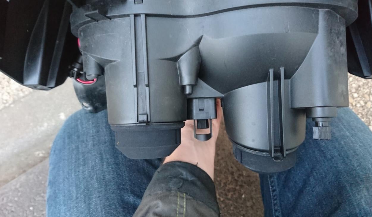

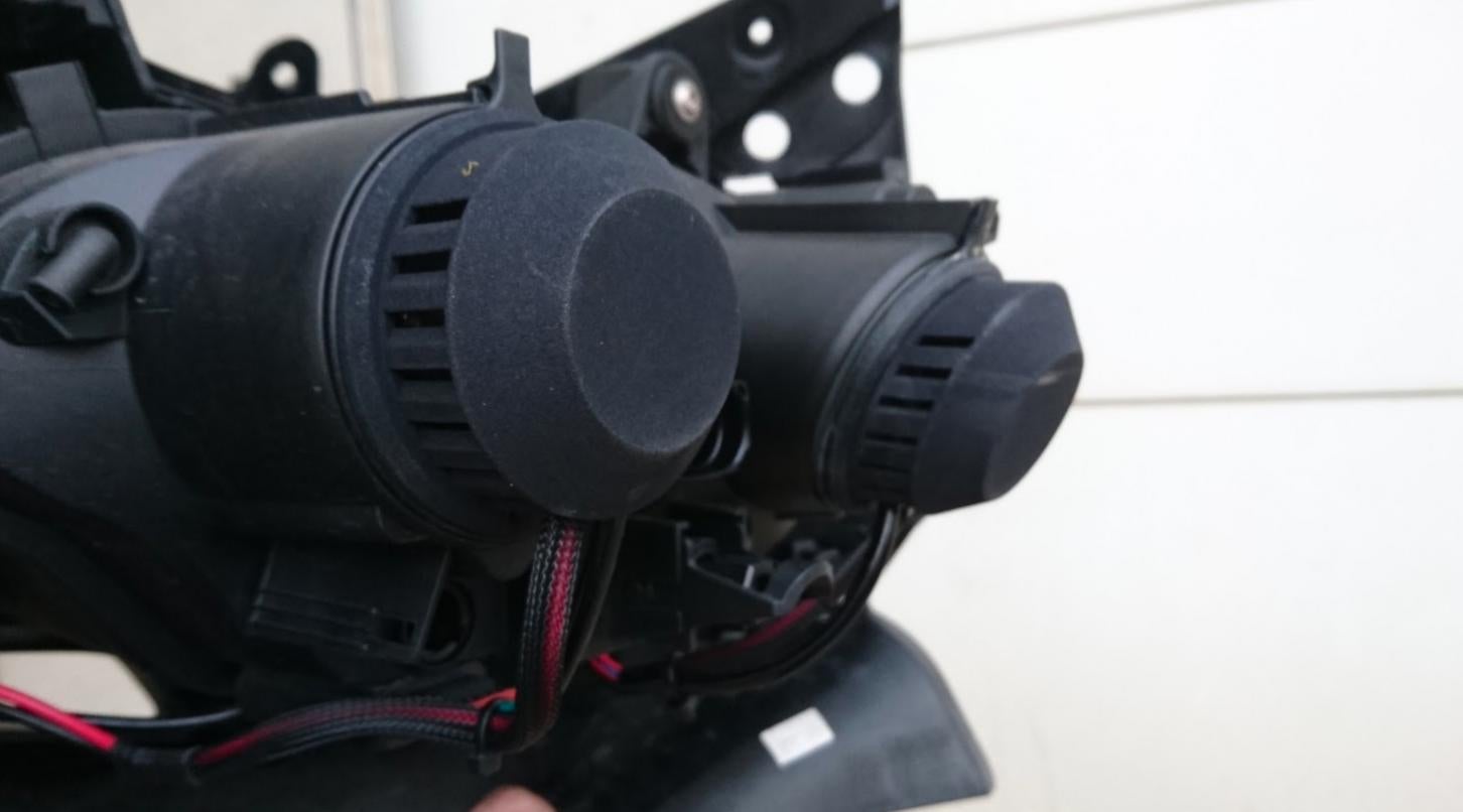

Now, since the back end of these bulb is more prominent that the stock halogen bulbs, I noticed that I can't put the lids back in place. See this picture about the stock lids:

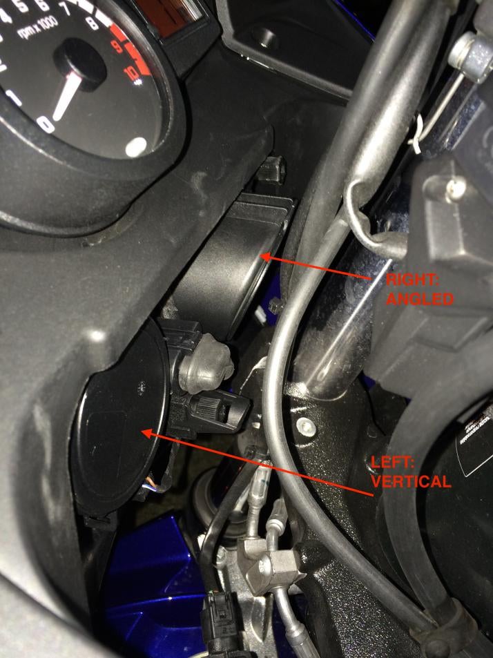

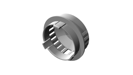

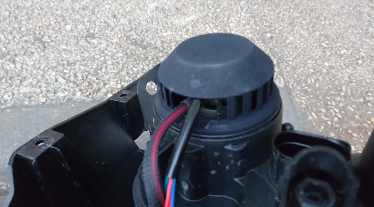

So I designed a pair of lids that would snap into the headlight block in lieu of the stock lids. Those would carry a emboss to clear the bulb back end, while being rain proof and providing the required venting, and cable clearance. I used Solidworks to create two digital models of the parts:
As you can see the right side is a bit different as it has to accommodate an existing 23° angle. The depth of each of them was defined based on the required clearance of the LED Bulb back end and the full left / right fork end point.

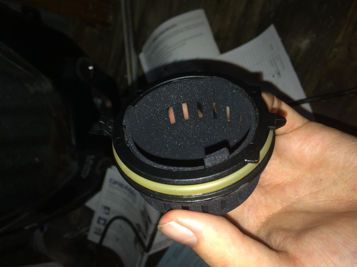

I then 3D-printed them online using selective laser sintering and got them in my mail 10 days later :)
They fit perfectly and give a nice industrial finish to the modification.

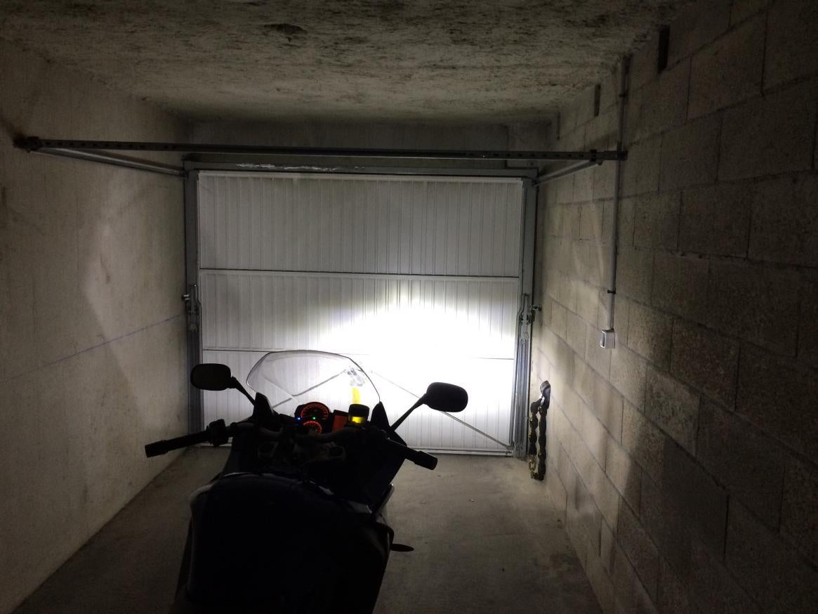

#4 ·

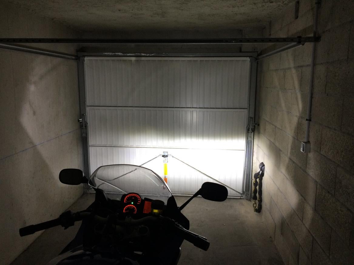

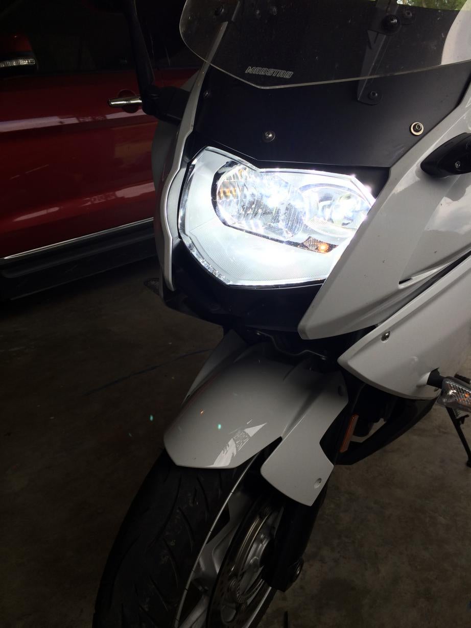

Thanks Mark,
I don't have pictures of before, but here is how it looks with the leds on:
This is an iphone pictures, so the camera sensor didn't cope with the light..
I can do some more perhaps from outside and at a distance to show the light beam.

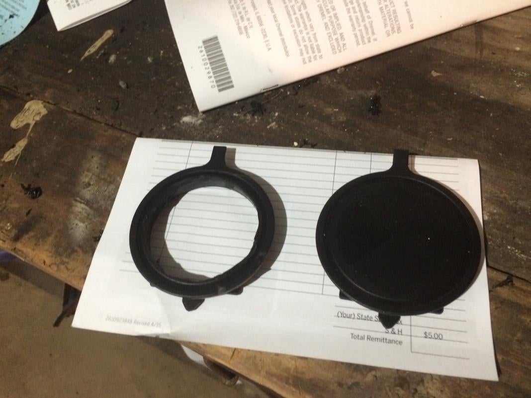

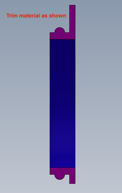

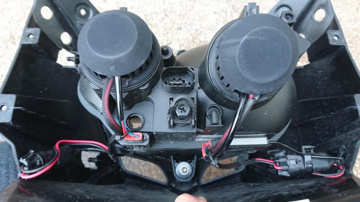

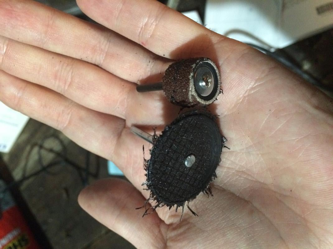

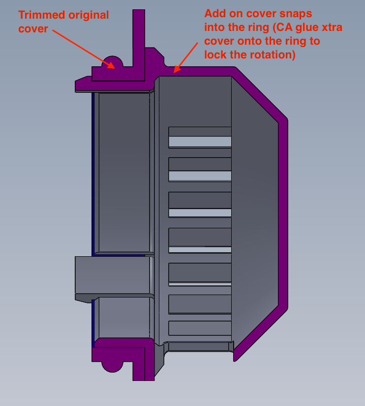

BTW, here is a recap about how the cover works:
1) pull out the covers and use a dremel to trim the center material as described in the pictures. This takes about 5' to do, just wear eye protection.
2) snap in the cover and rotate it to get the alignment. The tab is located on the top side. Use some CA glue to lock the position.

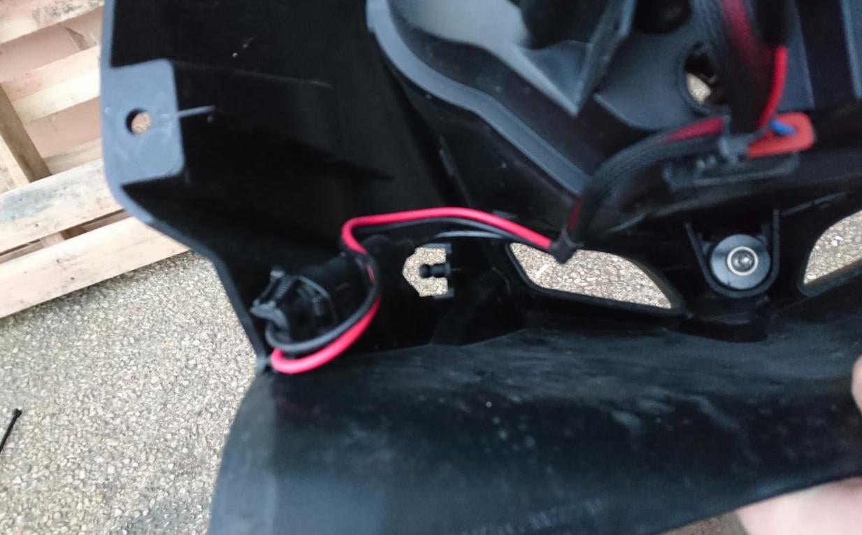

3) install the bulbs and route the cables thru the dedicated cut out in each cover.
4) clip the modified covers on each side
5) attach the external ballast with double sided tape underneath the headlight block
6) connect to the existing power source
7) "let there be light" :)

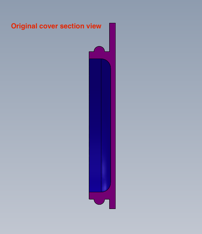

for info, here is a section view that shows the space gained.
Cheers,

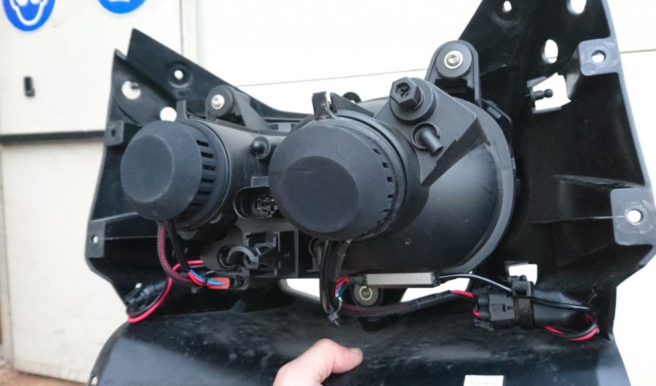

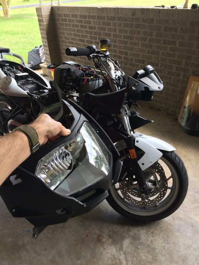

Here is a write up from my experiences in doing this LED install.

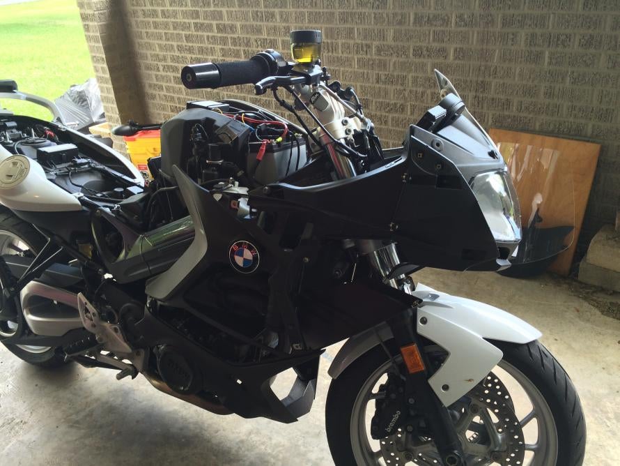

DO NOT expect to install these LED bulbs without taking a lot of plastic apart. It is probably possible, but for me I took the headlight assembly off.
First, I got the caps from Shapeways.com, which BlueSkip made (Remi). Use a dremel tool to remove the center material,
then glue them in place. I used a two compound liquid glue. This took less than an hour to complete.
Taking off all the plastic is not hard and only took me 45 minutes to complete. Here are the steps (from Blueskip):
"- remove the saddle
- remove the central cover from the airbox (fake tank alike) you DO NOT
-remove the two black plastic triangles (L&R) from each side of the gauges
-remove the low side fairings (L&R)
- remove the mirrors
-remove the up side fairings (L&R)
-remove the windscreen
- gently pop out the ambient air temp sensor support from the headlight block and leave it hanging from its harness
-turn CCW 90° the little running light support to remove it and leave it hanging from its harness
-gently pull straight out the headlight power connector (oval shaped) from the headlight block. It is connected between the two lights and has a 90° socket.
- unscrew the 4 screws that hold the headlight block onto the front structure. These screws are inserted from front towards the rear into some sort of aluminum clips. Warning: if you see traces of blue thread-lock on the exposed threads, do not attempt to overcome the torque. Instead gently heat the screw tip with a soldering iron for 30s and this would gently loosen the thread-lock without creating damage.
- drop out the headlight assembly"

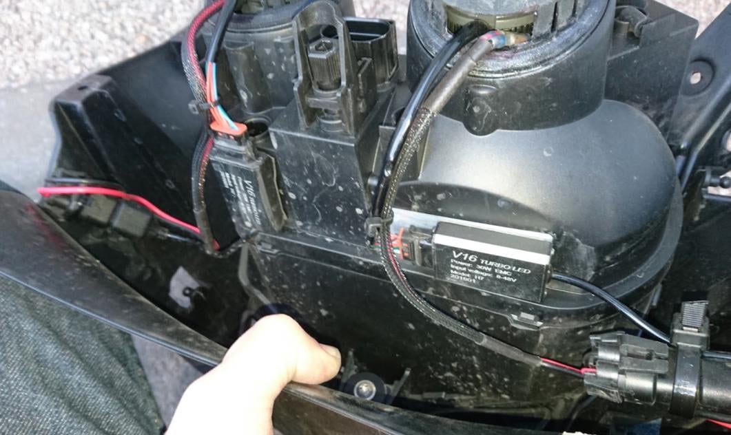

It seemed that these clips were impossible to place in with these LED lights since the blubs have a big fan behind them, but I used a pair of hemostats to hook the end of the wire retainer onto the proper loop.
NOT easy, but can be done so don't freak out and take your time.

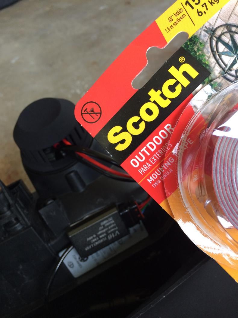

I used 3M outdoor double sided tape to secure the small box for each bulb.
You DO NOT need the resistors supplied to circumvent the CANBUS system. They are not needed. I used zipties to tiddy up in there.
Following the previous directions in reverse will get everything buttoned up. Yes, you will probably need to re position the aim of these bulbs with the nobs after this install.

Well this turned out to be a PITA. I had a go at installing the Cyclops H7 bulb. Against my better judgement, I decided to start work 45 mins before sunset (I'm in an apartment so working on the drive outside). That turned out to be a mistake. The Cyclops bulb base dropped into the rear of the headlight housing when I was trying to put it in. Then the retaining clip disappeared. I have NFI where it is. I hope somewhere in the housing as I can't see it on the ground. %@%$.
I'll have to pull the headlight assembly out. Are there any step by step instruction anywhere? I looked and the quoted text is as best as I can find but after my bulb experience I could do with some more pics.
That also mentions blue thread locker on the last 4 screws holding the headlight assembly. Is that on all bikes or only some?
