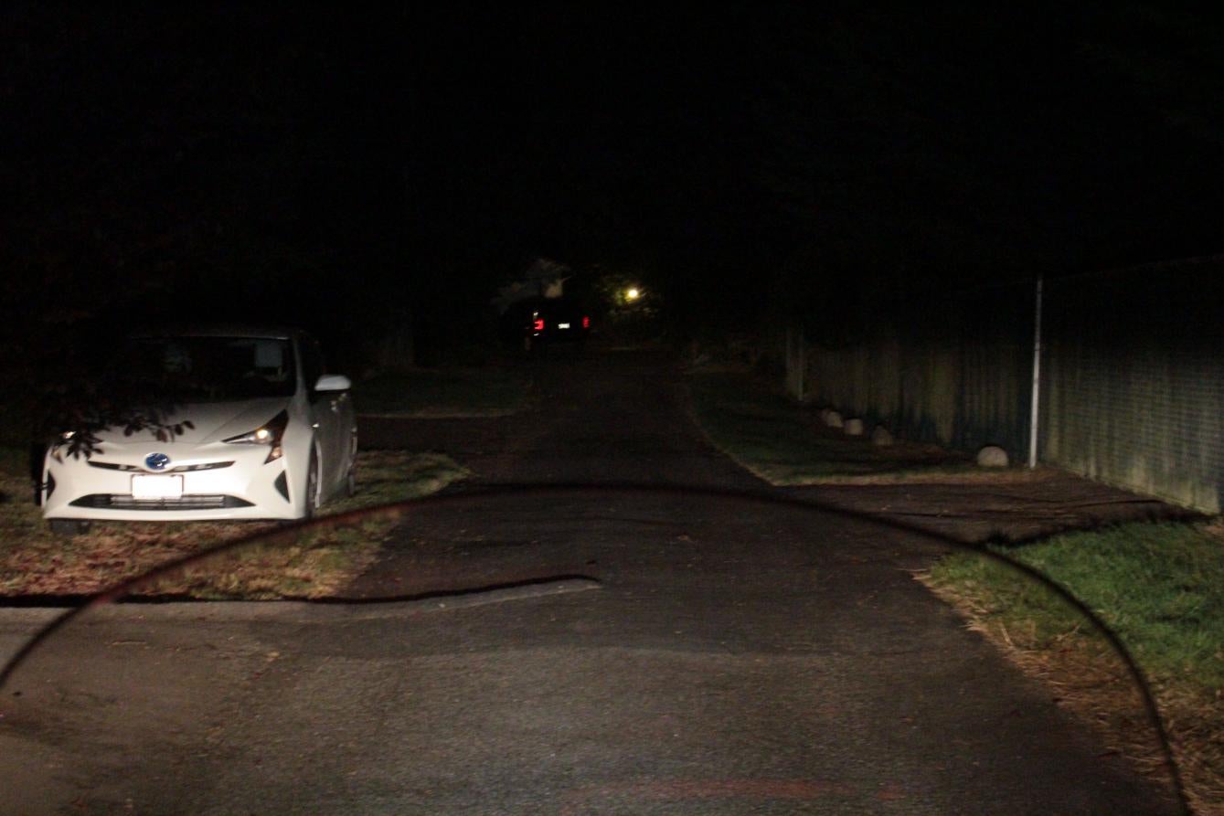

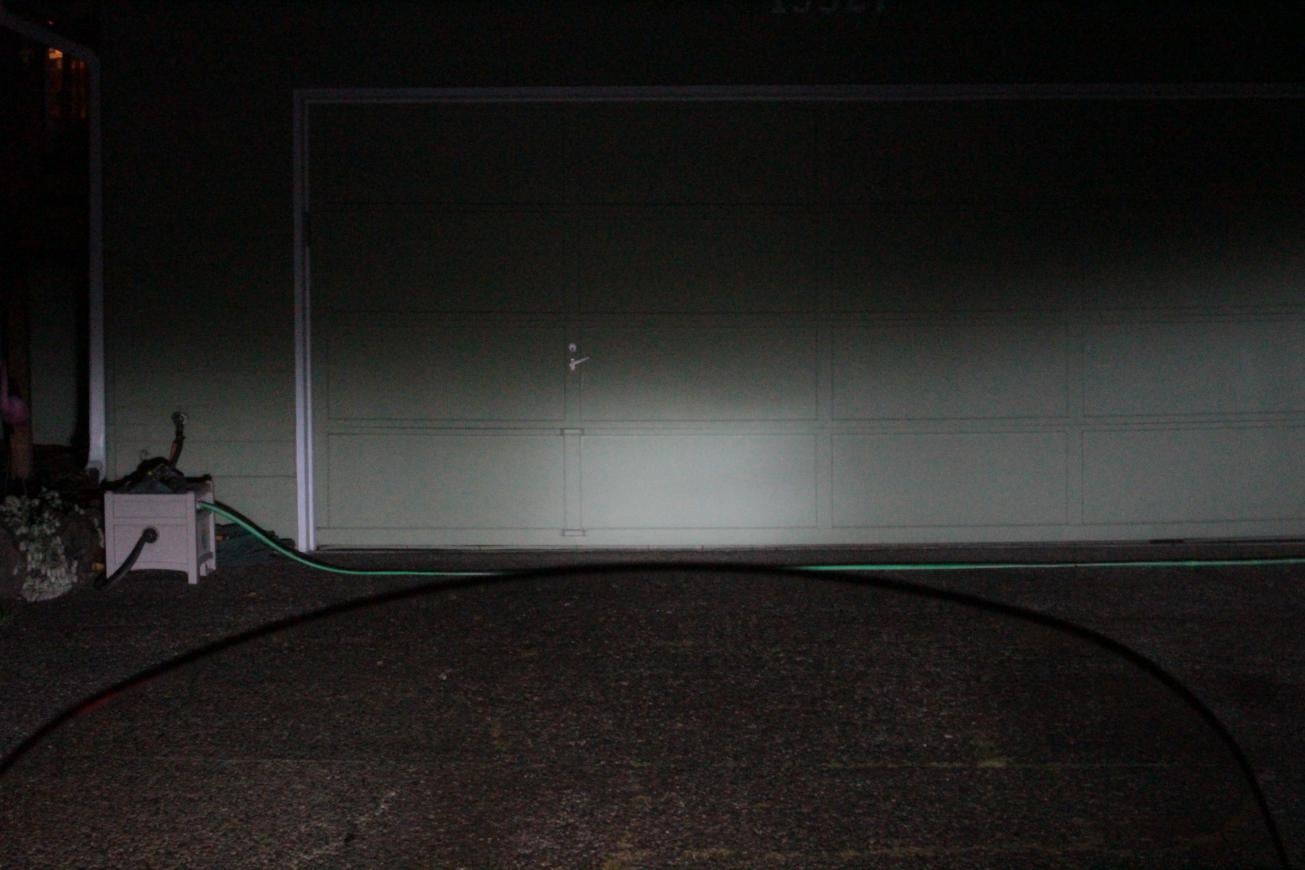

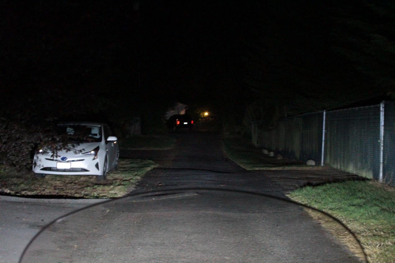

The lights are installed. There is an improvement, but it is hard to quantify. I tried to take identical pictures, i.e., same F-stop, speed and ISO settings. However, I'm just a little off on positioning. Across both pictures, I'm a little farther back with the LED headlights. Not enough to make much difference for what you see though.
I was hoping for double the light output since the LED bulbs put out 3400 lumens compared to about 1500 lumens for a halogen H7. I don't think it is that much at all.
Halogen
LED
Halogen
LED
You may see something different than I'm getting from this. But here's what I'm getting from this.
  • The light is whiter. Is it brighter?
  • The cutoff against the garage door is acceptable and far better than I've seen on another bike with HID lighting. In all cases, I'm holding the bike from moving with my right foot on the brake, which means the bike is slightly leaning to the left.
  • The light is concentrated in the middle...where the road will be. That's an advantage I think, because it is covering about double the area.
I noticed when I moved my Subaru back into the driveway that the lights are aimed higher than I have on the bike. I'm thinking I can move part of that light seen in the driveway picture out a little farther and get some additional reach on the beam pattern without blinding anyone.
All in all, while not a dramatic change, I'm happy. I'm getting better lighting...and saving about 50 watts total in my alternator budget.
